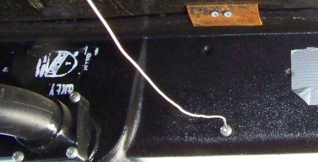

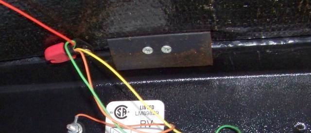

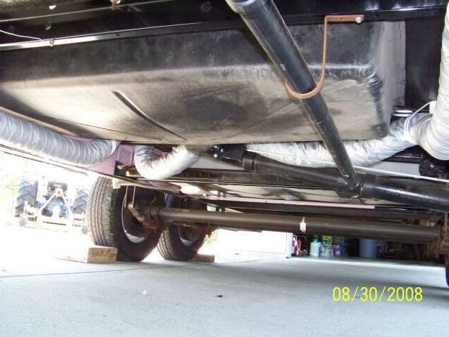

Theses ABS tanks are mounted into the floor joists of the camper. Screws into the wood and clips on the side. See the pics below. These large surface area tanks bow too much in my thought process to handle the tank shock of highway speed bumps and not have an issue. My TT manufacture is out of business now and I cannot confirm with them if they will hold.
Towing black and gray full tanks slow going is not a problem, been doing it since 2003 and no issues. We have a 35 gal gray and 40 gallon black tank. If I end up changing our camping locations to remote areas where I need to haul black and gray at highway speeds, then I would build a support frame under each tank and tie the support frame to the main frame rails.
How is yours setup?
See mine with the coroplast cover off. The black tank
The gray tank and the mounting clips. The black has the same clips screwed into the wood floor joists.
