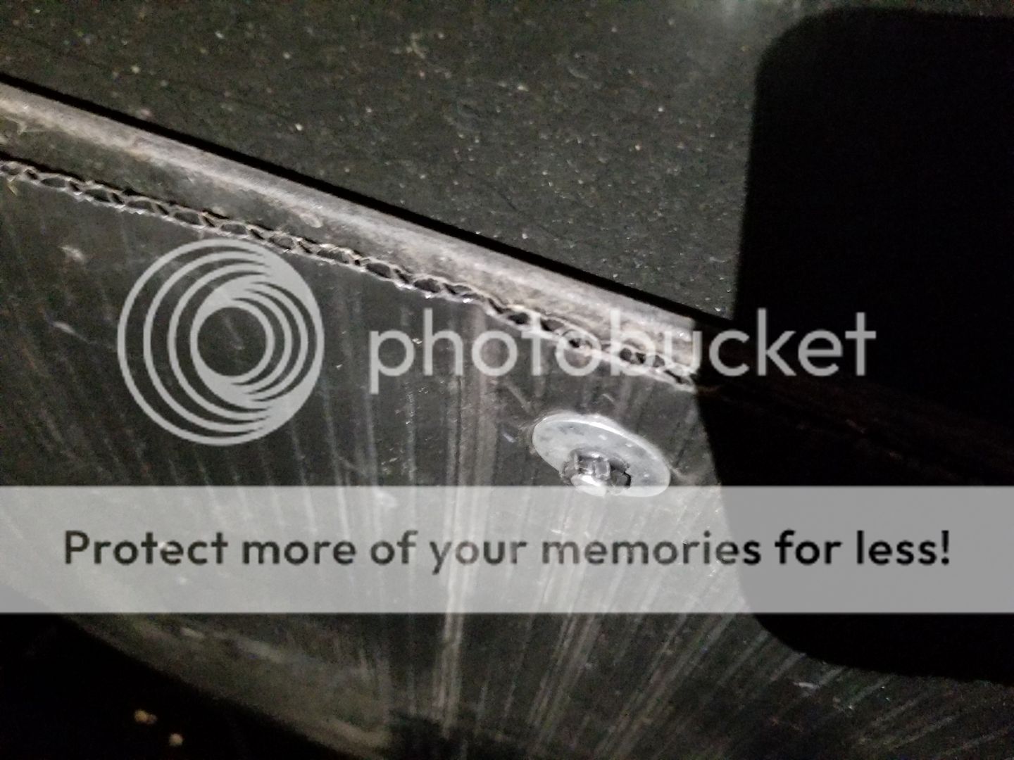

    These are ramset pins and can be pried off. You can use a 5/16 socket on them to loosen them up. It won't back them out, but it will help break the connection and make prying easier. You can also so this with vice grips.
    Take a pry bar, screwdriver, or the claw of a hammer and pry the pins out. Put the pry bar between the colorplast and the frame or between the colorplast and washer. If the head pops off, then just get a really good bite on the pin and pry it out. If one snaps off flush with the frame, just forget about it.
    This is how I got all of mine out. Replace them with washers and self tappers. If you want to reduce the likelihood of sagging in the future then use more fasteners than the factory used.

  • budwich wrote:
    that just a standard bolt that the plastic pulled thru during its install which might make it harder to get at the bolt head. Just clean away the plastic and use the right size nut driver to take off the bolt.
    It's not a standard bolt. Its a hardened pin shot into the steel with a specialized pneumatic nailer. To remove you use a 4" grinder with a wafer wheel or a cutoff tool, and cut off the head, then after you remove the coroplast grind off what remains of the pin flush. Pulling those out of the steel is tough as they have flutes on the shank of the pin. After they're ground off flush you can take a drift and punch them through in the direction they went in but it's time consuming.
  • that just a standard bolt that the plastic pulled thru during its install which might make it harder to get at the bolt head. Just clean away the plastic and use the right size nut driver to take off the bolt.
  • Ok, thanks folks. These don't look like pop rivets, they almost look like a bolt but you can't unscrew them.
    If I cut the underbelly, what kind of tape ought I use to tape it back up?
    Thanks
    Scott
  • ScottyP5947 wrote:
    I know there is an option to cut the underbelly and re-tape. I'd rather not do this, unless it's the way it should be done.
    That's how I've done it - no issues at all and much easier than dropping the underbelly.
  • Drill the pop rivets out. No big deal. If your is anything like mine you will find 4 inch fiberglas batts laying on top of the plastic. When you figure out size, go buy a batch of SS self taping screws and flat washers to secure the sheeting back up.
