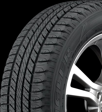

    I got wrangler HP's now.. But treadlife only 340... I guess I just go with RSa;s goodyears.
    $120 a tire.
    I failed to mention Im cheap and broke..
    https://tires.bjs.com/tires/view/103845/goodyear-wrangler-sr-a-p265-70r17/?quantity=4
