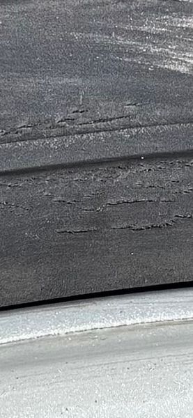

IMO, don’t waste your money on Hankook Trailer tires! In November, 2023, I bought 4 new Hankook Vantra TH 31, G Rated tires for my 5th Wheel. After 18 months and about 10K miles I noticed all 4 tires had numerous hairline cracks extending out about 3/4” from the bead/ wheel. As advised by the dealer, I contacted Hankook and explained the issue. Hankook has refused to allow any compensation for the tires because they do not consider the cracks a “Warrantable Defect”. They even made the ridiculous claim that the cracks probably were a result of my not using the tires enough! The dealer was totally taken by surprise at that answer. IMO, do not use this sham of a Korean Tire Company’s Tires. I just couldn’t risk a tire failure, that could cause $1,000’s in damage and repairs, so I bought a set of Carlisle Tires (made in America) and am out the $1,000 + cost of the Hankook.

  • do you have a picture of the cracks, I am having a hard time picturing this.
    but the manufacture is telling the truth, RV tires can crack from being exposed to the sun and not being used.   a combination of factors contribute to this, including UV radiation, ozone, and the lack of flexing that occurs when tires are in use.  this is why most long term rv's have wheel covers on them.

      They've always been covered when not in use. I don't buy the cracking due to partly not being flexed much, because I have several friends who I travel with and use their 5th wheels about the same, who've never had cracking like these.
    • Cardaronella's avatar
      Cardaronella
      This is typical of the cracking all around the tires on all four. If you further expand the picture you’ll get a better idea of what the look like under load.

        Them are some ugly 18 month old tires. What’s the mfg date?

        That's right, mfg. date was 12-23 (12th week of 2023) and on the 5th Wheel about 18 months and run about 10K miles - ridiculous! Small Claims here we come!

  • Agreed on the issue being warrantable. Not sure I’ve ever seen tires cracking radially at the bead. Certainly not tires that were not otherwise old and dry rotted.

      Do you think the cracks at the bead might indicate a manufacturing flaw rather than just environmental wear? I've seen many tires age poorly, but radial cracks near the bead after only 10K miles seem extreme.

        I’ve talked to several tire shops who say they’ve only seen radial cracks in much older tires, so I’m thinking it’s a manufacturing defect, but Hankook says no and won’t budge on offering any type of adjustment. Several tire shops also say Korean and Chinese tires are bad, so I’m sticking with US manufacturers. I put Carlisles on as replacements.
