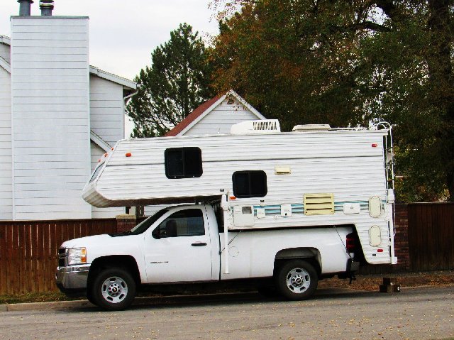

Hi guys, you may remember I posted last year about my 2002 Lance 811 that I acquired for free because it needs a little restoration ("How Bad Is This?")
Well the house remodeling is finally done, DW has her brand new kitchen, I sold the TT last week, and the project is ready to begin!!
I found this in the owner's manual, which was apparently prepared by the factory for this specific camper.
The previous owner was running this on a 80's vintage F-250 with 351 and 4-speed manual. I'm starting to scout for trucks and have some initial questions:
1. The weight is listed as 3017, so with full water (30 gals) and gear I'm probably in the 3600 lb range loaded? (the gear in the TT was 1600 lbs but it was 32' and had too much storage).
2. At this weight I probably need a 350/3500 something, but is a dually necessary or advisable? Looking more to offroad with this on the beach than travel long distances.
3. The distances in the center of gravity drawing add up to 8' so I guess I need a long bed? Can I consider 6.5' beds or is that off the table?
I know there are variables in truck ratings but since I'm buying used I want to at least filter down to the type I'm looking for.
Thanks in advance and y'all are staying out of the path of this virus. It's been bad here in NY and have lost some friends.
