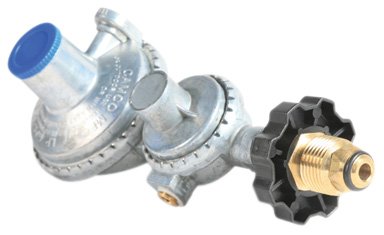

    The tank mount I posted a link to earlier is a dual stage, designed for horizontal positioning. No holder required since it plugs right into the tank. Only one hose needed- that's supply to trailer system.
    Yes, I saw that. But isn't it a little big to install on a 20 LB LP tank? I think it's gonna stand out pretty much from the bottle when connected, it will also put some stress on the tank valve... no?
    I think the horizontal regulator are designed more for horizontal LP gas tank?
    Maybe I'm wrong since I didn't have the regulator in my hand right now... but... :B
    "Horizontal" only applies to position of the regulator itself. That regulator is designed for direct plug in to a vertical RV bottle.
    Simplest fix for you might be just to take the regulator you already have and mount it on the trailer body, plug one side, and run your tank hose from there.

    You could use a Marshall Products horizontal dual stage regulator. 294-00. It would be supported by the attachment to the tank.
    Make sure the vent faces down.
