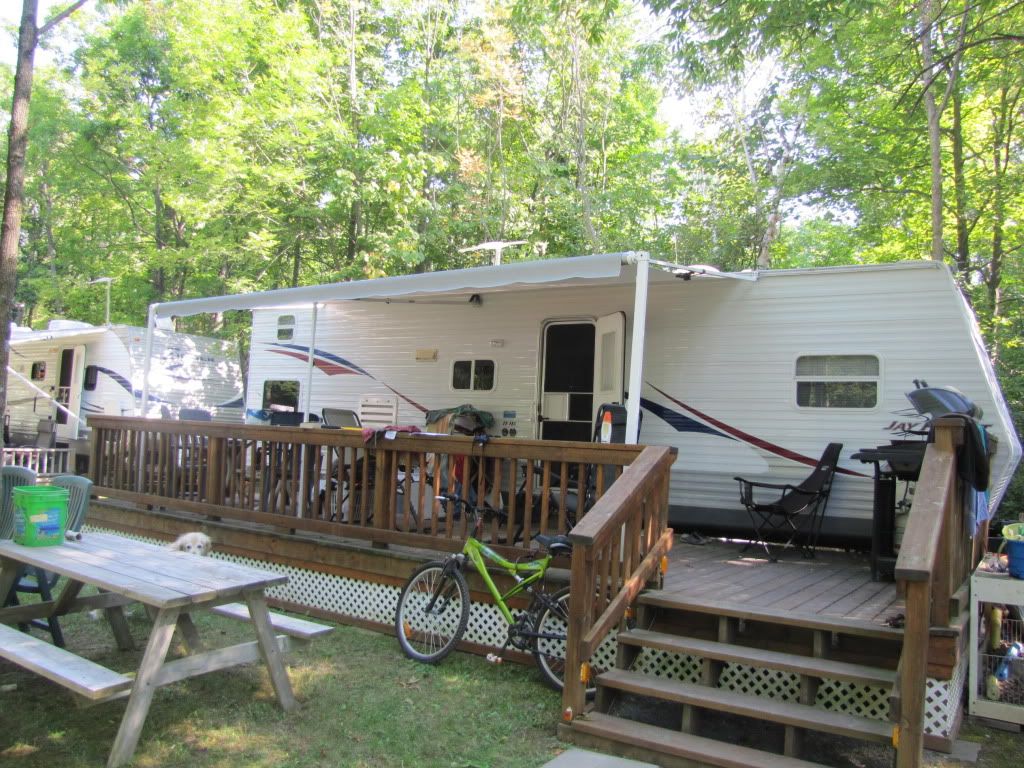

  • For my previous seasonal site:
    - Electrical ON -> with fridge on electric mode.
    Note: I installed electric Surge Protection as well.
    - Hot Water tank Off
    - Water flow Off
    - both Septic Valves closed.
    - LP Gas Off -> since fridge was on electric only.
    - roof vent open 1/4 -> to allow natural venting
    - furnace &/or AC set to Off.
    - 12 Volt turned off (via manual switch).
    - Side's Slide left Out. (only bring slide in at fall / for winter storage).
    - Side's large Awning Out (material kept tight and supported by both horizontal and vertical posts). re: - click here -
    To eliminate slide roof damage, I created a hard cover for our large slide. re: - click here -
    This worked great for my previous Seasonal site (for 7 years).
