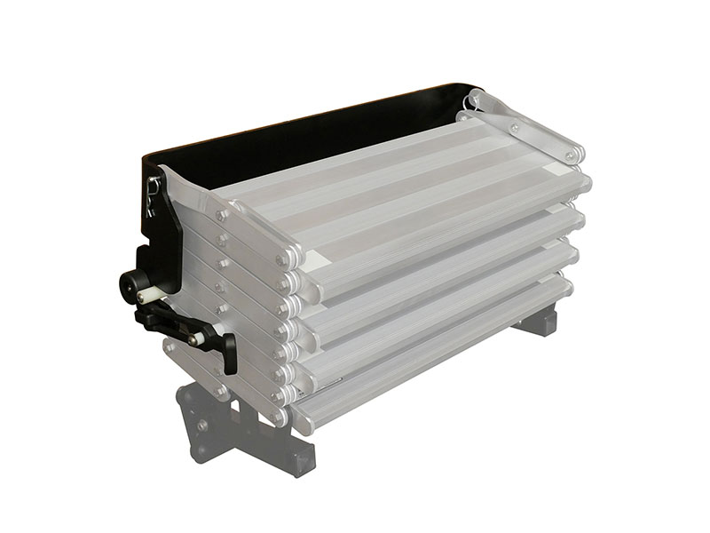

My first upgrade was to remove the original step and attach a set of Torklift Glow steps the the original step brackets on the bumper.
That worked good, but I needed to remove the steps when traveling since there was no way to secure them in place.
Glowstep Installation
A few months later I discovered the Stow-n-go bracket, so I installed it.
Stow-n-Go bracket installation
A while after the bracket upgrade, then I added another step.

  • Although the pins can mounted to any of the stairs, ideally they should be the stair closet to the snubber. With the stairs collasped and snubbed, there is no way for steps bellow the pin to droop, so there is no reason to move the pin to the lowest step. BTW: The Stow N' Go can be used for 3-6 steps, so your application using four steps should work at long as you clear your hitch.
  • Camper_Jeff_&_Kelli wrote:
    have you made any refinements to the original installation? Take care.
    I haven't refined it since the original installation other than adding a 4th step. The drawback to having 4 steps is the bottom step hangs kind of low when stowed, which is a concern with always towing trailer. The 4th step also doesn't get secured with the rubber snubbers. The snubbers are on the 3rd step.
    Most of the time I totally pull the steps off when traveling, but a few times this year I left them on and used a bungee to keep the 4th step tight against the others. I wrapped the bungee around all the steps.
    I haven't looked to see if I could move the pins that the snubber attach to from the third step to the 4th.... until right now as I am typing this, I hadn't considered it before.

    @Deltabravo: In your video, it looks like your glowsteps need a lot of force to extend. If you have not done that before, you might try some oil or WD40 or something at _all_ the joints (I know, they are many). It makes the stairs much easier to retract and extend.
