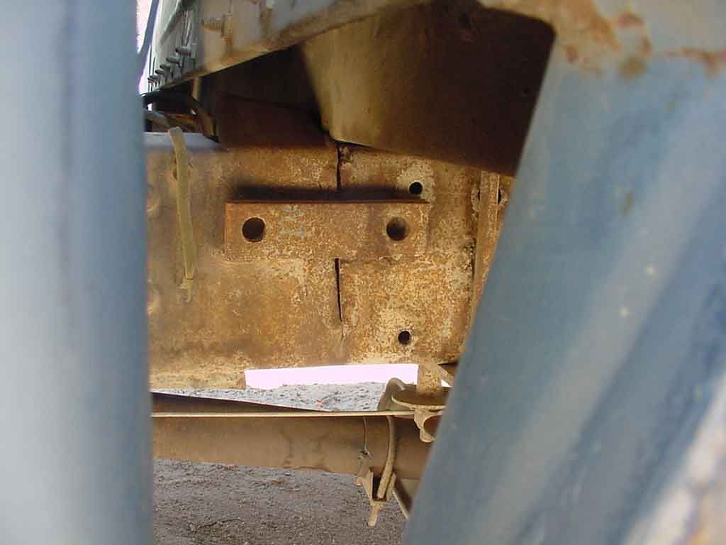

X2 - jerem0621Explorer IIWow, Ben that is crazy... that little bandaid will not stop the crack. He didn't even drill a hole at the end of the crack
These overload situations make our common 200-400 lbs over 2 times per year discussions seem petty.
These guys are overloading by TONS... not hundreds of lbs.

If this is true, the owner is crazy. I guess he spent a lot of money purchasing the truck and wants to "use it up." - BenKExplorerDangerous
With today's hydroformed frames...they are of higher alloy than the old days and
the hydroforming work hardens the metal alloy
Meaning that 'bending it back' only further fatigues that area...unless they
annealed it, then bent it back...then re-hardened it...which I suspect is highly
unlikely
Busted 'there' because the cab bolted to the frame effectively increases the
frame boxed area around the cab. Ditto the bed...that increased the boxed section
of the frame back there.
So the area where the frame bent/busted is just the frame's boxed
area...AKA stress raiser area, or weakest section
Dangerous and scary that there are folks with these bandaids out there... - ib516Explorer IIHere's what was posted after the picture was posted:
