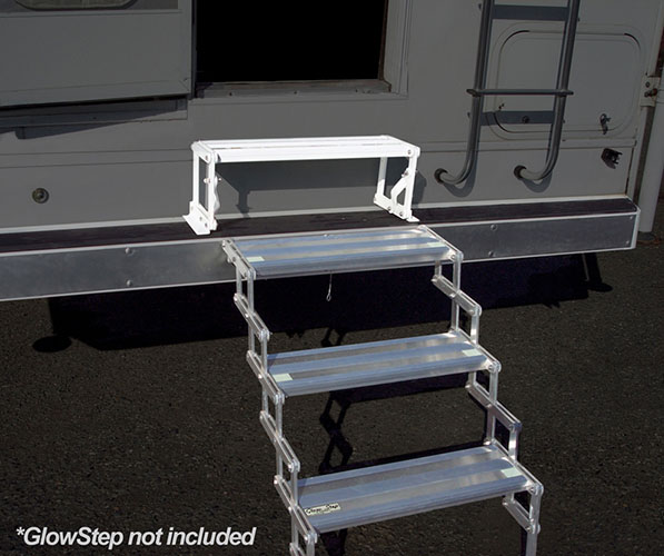

b - BedlamModeratorAt the time, I did not want to buy the folding basement step and the GlowSteps. Somehow my size 11's didn't like the transitions. having the scissor steps all the the way to the top keeps the stair size and spacing the same all the the way. I still feel the same way which is why I haven't purchased the basement step and relocated the scissors.

Side note... Why didn't you install the stair bracket on the bumper of the TC? Not possible? - BedlamModeratorI like the side entry. Our next TC will have a side door because we also tow often. Right now we have issues with the stairs not reaching the ground and needing seven GlowSteps. TorkLift typically does not recommend more than six steps, so I have a temporary solution. This is before I set the GlowGuide in place:
