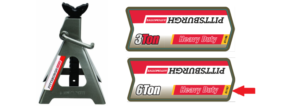

Not sure what you are doing with the jack stands. There is a weight rating need, and then a stability need.
I looked today at Harbor Freight and seemed to stop selling the 6 ton and the 12 ton stands. Must be that lifts are getting more popular and the call for larger jack stands are not enough for them to sell them anymore.
Point in this, I have 4, 6 ton jack stands and 4, 12 ton jack stands from HF. I have had them for a long time. I go for stability along with weight rating. And how I use them, stability outweighs the weight rating most times.

The 3 ton, will hold 6,000# per pair, just the foot print is small. For what I do with them, the 3 ton stand has too small a foot print for me. It all depends on what you are doing with them at what height.
