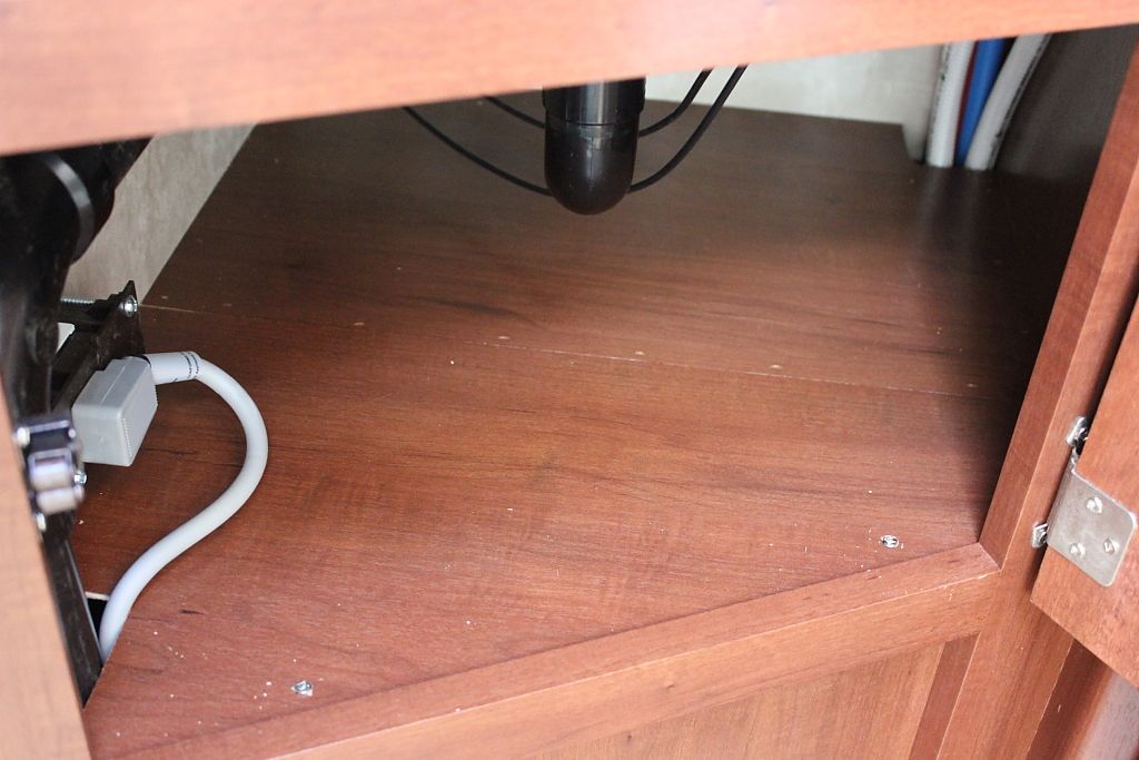

  • Very interesting topic since I also have a Minnie Winnie 2101DS, a rare white one, at least in my area. Here are some photos that I made. I couldn't get my good camera down in the tight space so I compromised and used my iPhone.
    The first photo shows the panel under the sink that must be removed. The other photos are pretty much self explanatory.
