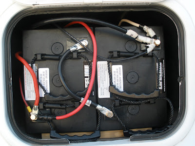

DJ,
I'm with Wayne on this one. The only way my 6v AGMs would fit in my battery compartment is on their side. If you buy the 6v 4ct size you may be able to fit both in there by placing them next to each other on their sides. You might have to rearrange/reroute some of your water lines to make everything fit, but it might be doable.
Here's a pic of my 6V AGMs on their side:
