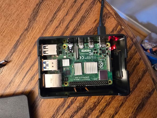

so while I wait for the cables I decided to get the RPI setup and operating.  so here the raspberry pi is finaly flashed with Venus OS and working.  took me a bit to figure out how to ssh into it to lood the package manager on it as the venus os changes some of the info, mainly your login name and password 🤔

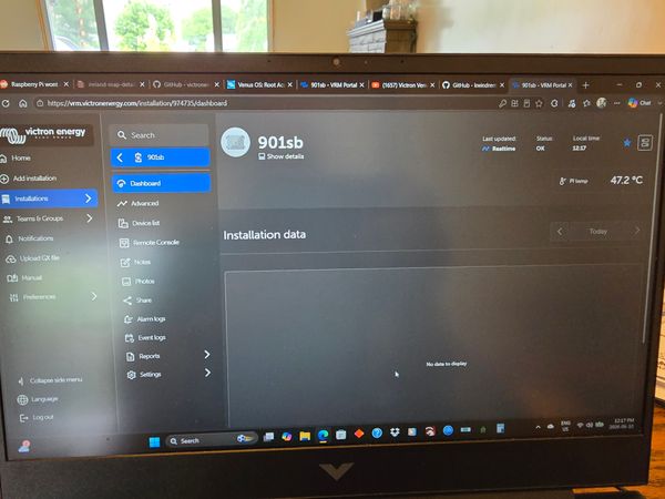

after I figured out how to enable the wifi and such on it  I was able to log on with victron conect.

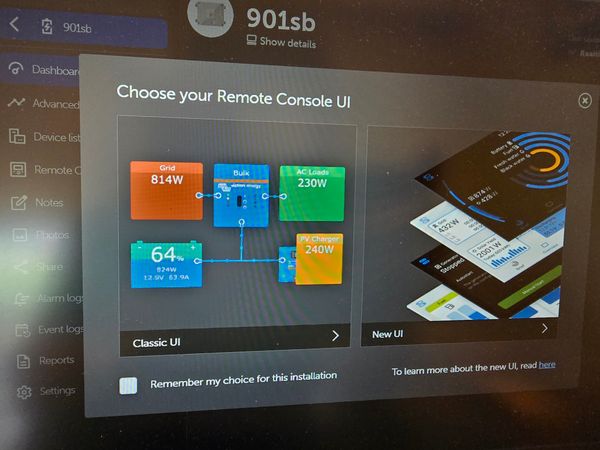

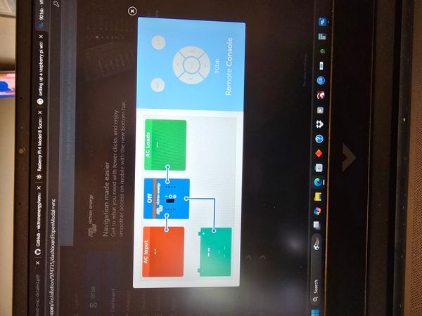

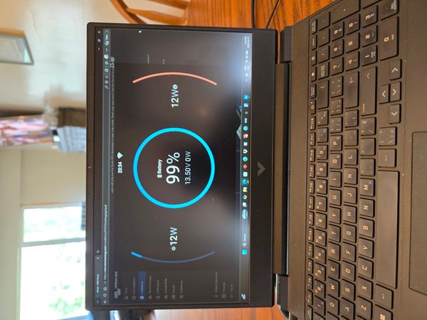

with the newest version of venus OS they introduced a new ui you can use.  you can switch back and forth between the two so if you like one over the other you can use your favorite
here is what it looks like when you have nothing hooked up with the classic UI

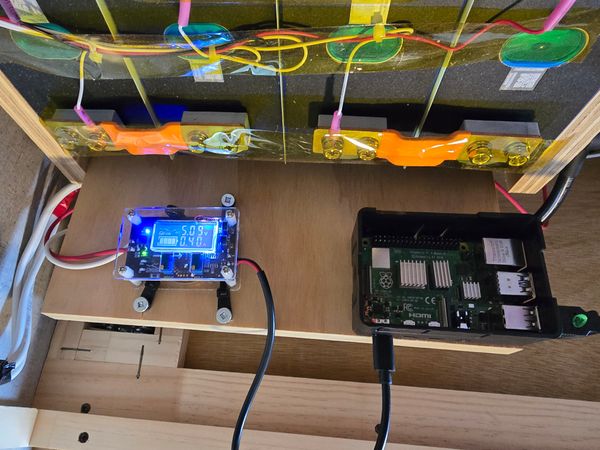

  • ok, so I got everything figured out and mounted in the truck camper.  I haven't hooked up the BMS yet as I found out the cable I got is a non isolated uart to usb and I want a isolated one that will eliminate any chance of a power spike through the common ground destroying my BMS or raspberry Pi.  so that will be later on down the road.
    so here is the dc to dc adjustable stepdown converter and the Pi mounted and wired in.  Yes the display for the stepdown converter is upside down, but it is right side up when I am adjusting it if that makes any sence.. 😉 excuse the getto mounting solution, I could have screwed the plastic shell to the wood, but then I wouldnt be able to put it togeather.. its kind of a bad design mounting wise.  but I came up with a temporary solution that has it firmly in place with the go to zap straps haha  oh and there was a button to toggle off the back lighting aso it is not lit up anymore.

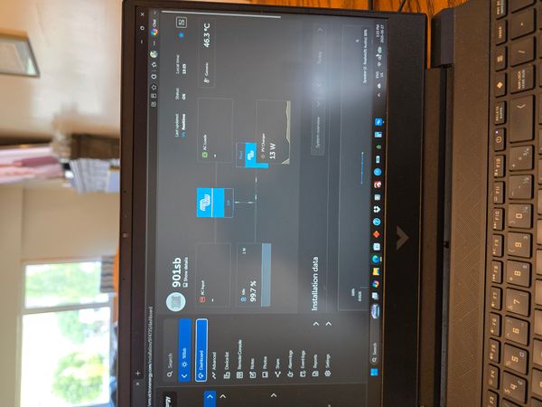

    so after an hour of trying to figure out why I couldn't conect to it, I noticed the memory card on the counter while reaching for a beer.  after a min of cursing, I powered down the pi, put the card in and repowered it up and all was good.  now I just have to get a victron inverter and everything will be done.
    and if you have a cerbo or this setup running the newer firmware versions they have a new UI you can pick from, I kinda like it for a static display when I get that part figured out.
