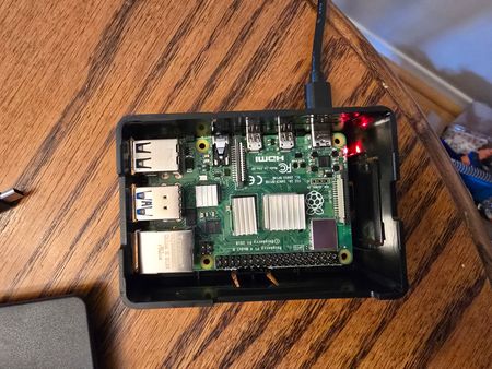

bluetooth does give a lot of info, if you happen to br right there. for example I have my truck and camper parked 65 feet away on the side of the house and I can't log into any of my bluetooth right now. so it will let me check on things a little more easier around home, but also I can set up alerts if somthing is going wrong. then it makes it easier to check on things when I am not at the camper. the other thing it will do is by alowing me to bring my BMS into venus os I will be able to see everything with one program, yes if i have to make setting adjustments on the bms I wil still have to log in with its bluetooth. if I would have knowen i could bring the BMS in before I bought my stuff I wouldn't have bought the smart shunt as the BMS will give me more information and that information can be used to control the mppt charger.
but, as I am discovering , the more I dig into it, it is not just about reciving information, the cerbo combines everything and lets them work togeather. and by installing the "large" venus os package I get node red and signal K which one is a plc type programing program, the other is a feature control system they use in boats and such to tire all different kinds of features into one package. now am I addign navagation and helm controls, nope but I could add relays for cooling fans and wireless bluetooth tempature and humidity detectors and I may want that fan to turn on if that temprature reaches a spicific setpoint, or maybe I want the furnace to start if it reaches a lower setpoint. not saying I am tieing in the furnace right away, but thats the kind of possibility thoes packages give you. The is also the victron componant controle its self that the package brings in. if I go with a compatable inverter I can have the componants control each other, your battery id full and there is no draw on the system, it will shut down the solar controler, or force it to float faster. the inverter turns on, it wakes up the solar controler and such. then using the singnal k and code red I can progam my own pages to turn different add ons on or off vie the relays it can control. so I can set them for auto values or have a button programed on a screen in venus os to toggle it on or off, or if it is a 3 way there is that also. so you could start a fan on your drive home from sightseeing to cool down the inside of the rv or what not.
It is actualy quite amazing that victron open sourced this as a raspberry pi 4 is probably 4 to 5 times more powerfull than the cerbo gx its self, so while you can dasy chain cerbo units you just need to keep adding to the RPI and thats where the cost difference gets rael huge.
I started as I had a spare pi laying around still in the box, then I figured well I could add the patch cords for 35 bucks each and the other for 20 and a screen for 50 bucks. I will have to 3d print the screen and pi housing/stand. so if I had to buy the pi also, I think they are about 150ish right now so I would be up at 300 right now for what would have been 7 or 800 from victron (cdn prices). if it was going to cost near the same as buying the stuff from victron then I wouldn't have bothered.
