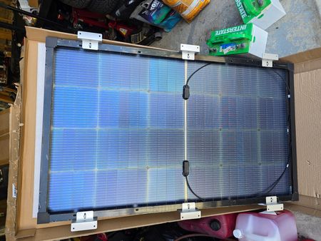

I was actualy thinking about trying to straiten out the bent panel they replaced and see if I can figure out a way to put it on the ground and add it into series with out having to climb up on the roof every time. or I may just sell it to a frien who is bugging me about it.. I think the wiring wold be to hard to make that work and I don't want to have to load it and unload it all the time.
