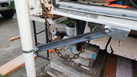

when do you use them, when loading and unloading?
- Camper_Jeff___KJun 13, 2025Navigator
I keep them on the jacks in the swung up out of the way position all the time. I connect them to the camper bracket all the time, removing, loading, and storing. They work so well stabilizing the front jacks.

I have never seen such witchcraft before, only time I have seen stabilizers is for units being used off the truck, and there's very few built to be used that way. those on my camper would drive against the truck box so I was curious when he was using them as they would be unusable for unloading and loading on mine, and I have hydraulic jacks so they aren't usable off the camper either.
- Camper_Jeff___KJun 14, 2025Navigator
At the camper, they attach higher than the fender. Clamped to the outer non moving jack tube, they are wider than the fender. The down and autward angle of the bracing bar also clears the dually fenders. There is no interference by a comfortable margin. I will use them whenever raising, lowering, or sitting on the ground. Only time to disconnect them is when on the truck and the jacks are folded in.
