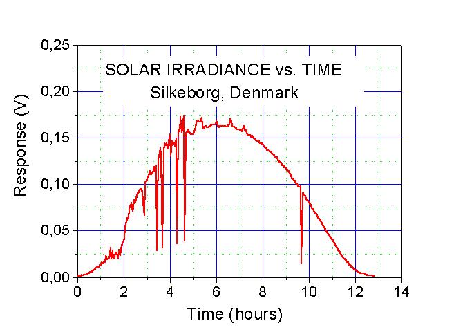

Then he suggests that "discrepancy" could be because the irradiance was lower. In fact, if that were lower then the input would be less and that would make the controller's output look better! Oh well. It is easy to get mixed up sometimes reading all this stuff.

1. Irradiance fluctuates. You could be measuring mppt current when irradiance was lower.
