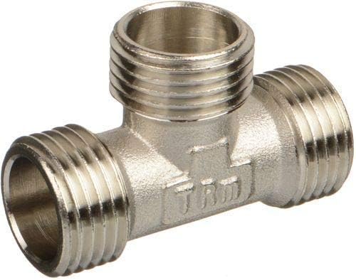

Another option is a "TEE", cap off one side and connect line to the other..looks like this..
