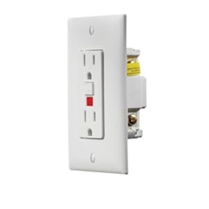

    Have you checked for 120 volts at all the various receptacles? Many are connected to a GFCI recept. somewhere. The GFCI breaker can occasionally be hard to find and sometimes there is more than one. If the MW and TV are working, the 120V system is likely fine.

    The first that comes to my mind is to check the GFCI breakers. I have three in my trailer. These may have other 120VAC receptacles down the line controlled by the one GFCI breaker. Make sure all of these are reset. There are the ones that have the PUSH BUTTON in the center of the receptacle. Just about anywhere you can come in contact with water you should have one installed there.
