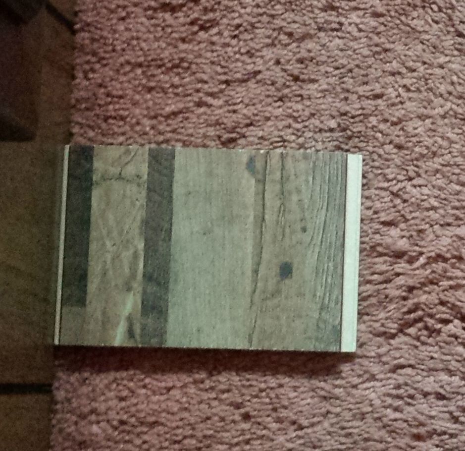

I settled on Pergo Max in Ironmill Maple to replace my 30-year-old, orange (sort of) carpet. It has enough variety in it to go with the existing paneling and the upholstery while also allowing me to redecorate later if I want. I had been leaning toward the Allure, but the non-adhering adhesive thing concerned me. The Pergo Max is a bit more expensive, but has a built-in pad and snaps together without adhesive.
I'm not trying to match the butcher block counter, but I don't necessarily want the floor to clash either. The paneling on the wall is dark (and dated, I know).

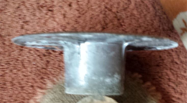

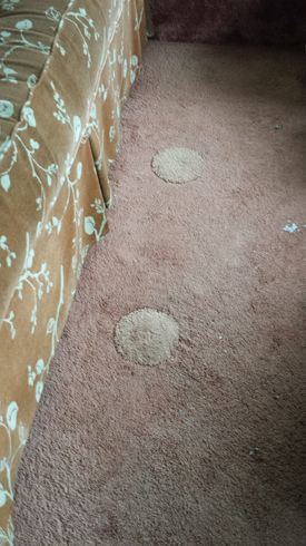

There is a table that I can install in front of the couch at chow time. It has 2 pedestal mounts in the floor.
The holes are sort of covered by these carpeted "plugs":

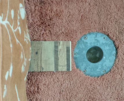

If I were put the mounts down through the new floor, they'd be almost flush, but stick out visually because they're aluminum.
So do I recess the mounts in the floor and fashion "plugs" out of the laminate floor pieces? Or just mount them flush with the floor and put carpet or something over it? I'm going to put area rugs in there anyway.

    If you don't use the table often, I think DrewE has the right of it. It looks like the sockets are raised just a bit off the subfloor, so I don't think you would want to leave them in place when you redo the flooring. If they are flush, no problem. In any case, after you pull the carpet, I'd take a piece of butcher's paper and lay it down over the sockets and against the couch. Mark both sockets and the ends of the couch or other fixed object. Now you have a template to replace the sockets if you change your mind. Then store sockets, legs, table, and paper all together.

    You can always stash the original table and hardware in storage somewhere and relatively easily go back to it if the folding table proves too anachronistic or something. The only requirement would be to carefully measure where the centers of the holes in the floor are relative to some fixed points. To put the sockets in, you'd just have to locate these centers (plus or minus a half inch or less, probably), drill a hole, and use e.g. a router with a template following bit to cut the laminate flooring to match. (If you aren't familiar with it, this bit is basically a straight bit with a bearing on the end; the bearing rides the template, or in this case the hole in the subfloor, and the cutter cuts the material above to match.)
