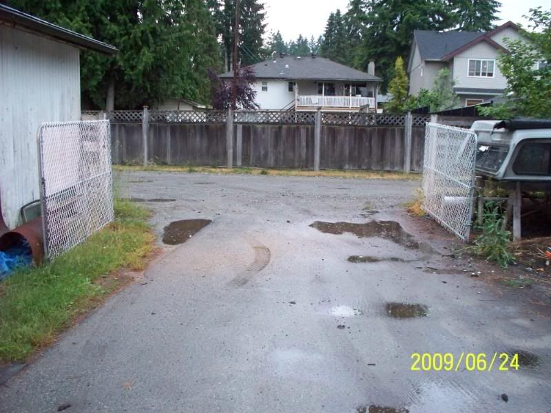

So to try explain, since the pictures were taken I had a new fence built along the side of yard, so put in two new gates I had made, but that only opened up one area, so now I found when bringing fifth wheel out it is tight to garage overhang which I cut back a bit, and it is doable going out, but backing back in it is tighter due to the alley and neighbours fence across the way, plus it seems just as I get the trailer in I am going to hit the gate with the truck on the section of fence left on, so now I am picking up a used gate and am hoping on the right side to join the two together so I can still open just two for regular traffic, but will be able to open wide up for backing back in with fifth wheel attached, any ideas what one can use to join two together and allow them to pivot?

  • Thanks for the feedback, since the picture that corner is all cleared out, so it is the gate that when it is back I hit, but maybe trying to swing it out into alley would be good, but I think it still would be nice to have all gate and get rid of the old crappy fence piece that is left, but I had not thought of joining two together by welding, that would make like one said one to open for car and the other open only for fifth wheel.

    Before getting too tricky with double swing gates, try rethinking. Looking at the middle picture, I assume you approach coming toward the camera and then back toward the driver's side to get into the driveway.
    Move the topper out of the way. After you come past the driveway, swing the gate on the topper side OUTWARD into the alley. This lets you tuck the tail of the trailer into the space where the topper is now on the first pass. Pull forward and center it on the second (or third) pass. Might be worth a try.
    I have seen double hinged gates in industrial applications that used a removable post at the hinge point. Set a length of 2.5" or 3" steel pipe into the ground at the point where the two gates overlap; flush with the surface. After the trailer is in, drop a full length piece of 2" (OD) gate post into the sleeve and chain the gates to the post.
