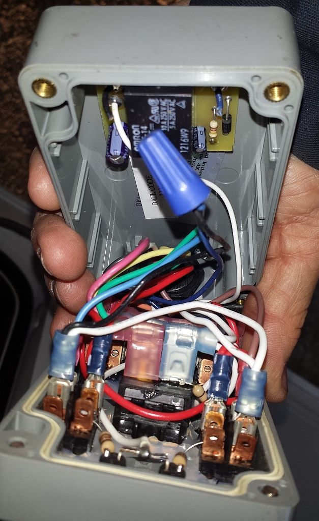

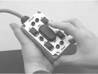

We have a 2007 Excel FW, with a Lippert hydraulic landing gear system. The remote pendant switches are starting to act up and not work. Here is a picture of the controller:
The switches giving me trouble, are the four black rocker switches. They are simple on/off switches. Here's what they look like, from the other side:
Has anyone ever seen shallow switches like this? I would rather change them myself, than try to fight with Lippert about it.
5 Replies
  • You might want to try cleaning the contacts with some steel wool or small wire brush, they just may have a slight bit of corrosion on them and not making good continuity between the contacts.
  • Check out O'Reilly Auto Parts. I bought some similar switches this last spring. They had a pretty good selection of switches. I would remove one and take it with you to compare. Good luck, John
  • I was able to buy mine at a local truck electrical repair shop.
  • I believe from your description of how the switches work and based on the pin configuration in the picture you want DPDT on-on switches.
    The most common configuration for DPDT is on-off-on so you have to look for that.
    Here is a switch on Amazon
