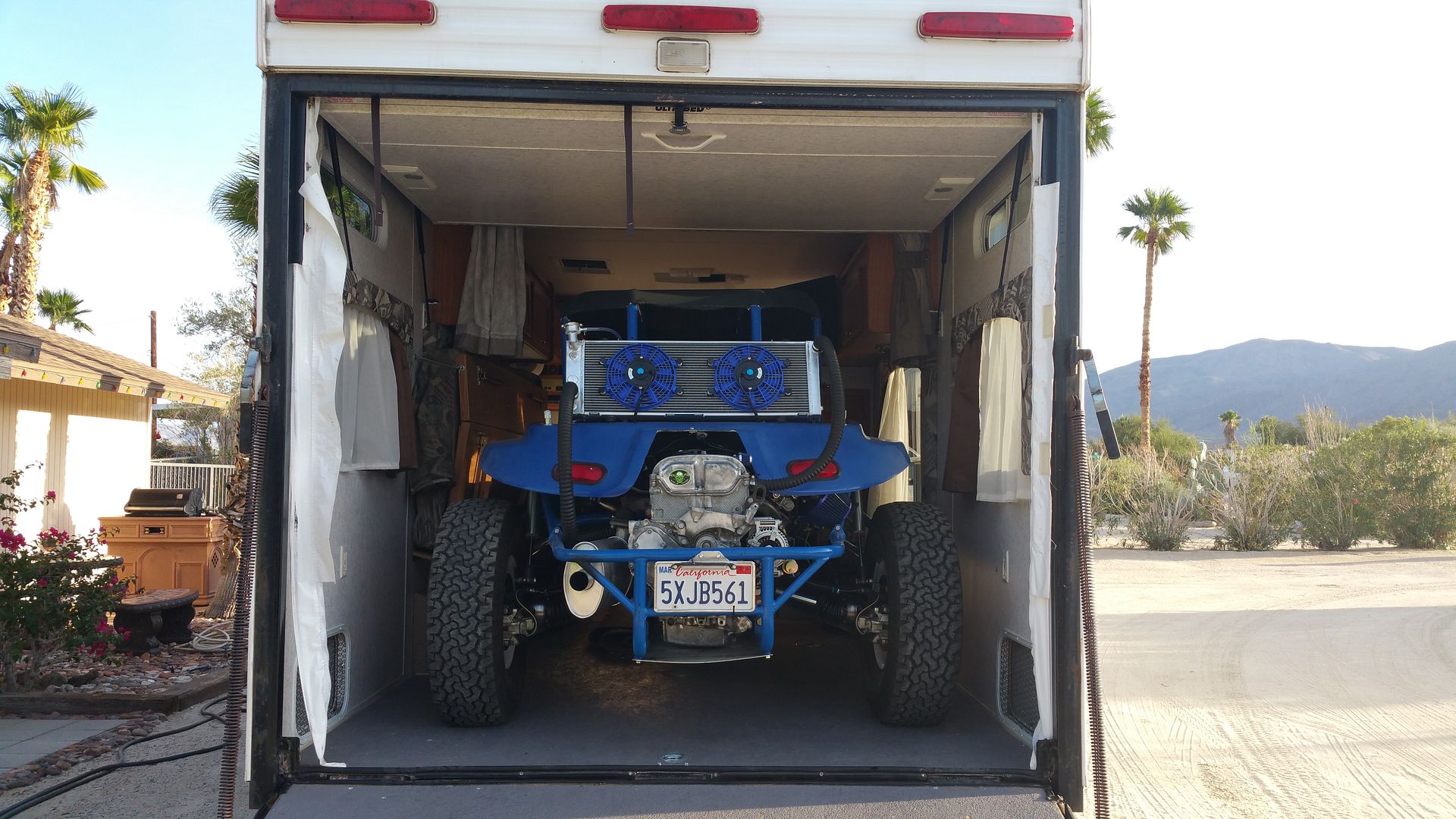

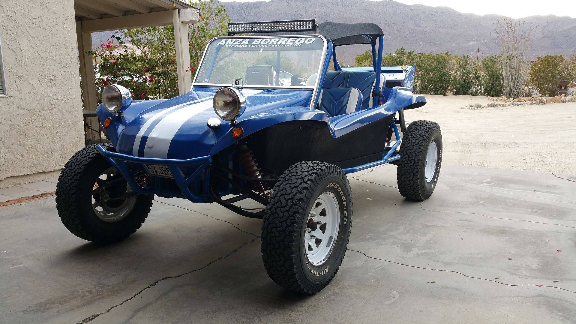

It doesn't have any issues yet but my buggy is pretty heavy so I decided to reinforce some stuff

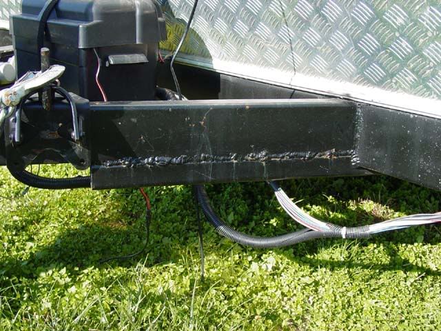

I did these horizontal braces that another guy did to stop the frame flex and wall dropping

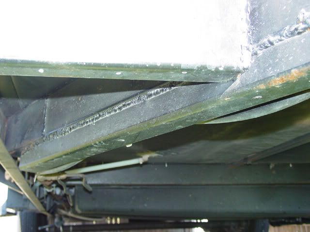

And now I want to reinforce the tongue. A guy said weekend warrior welded a square frame under the tongue like this. But it only goes back as far as where the tongue meets the trailer.
I'm not sure if that's good enough. Couldn't it still bend between the box and where the tongue meets the side frame?

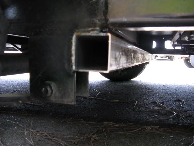

A member here did a different type of fix where he welded 2x2 square tubing underneath the tongue channel
I'm not sure if that would be better
