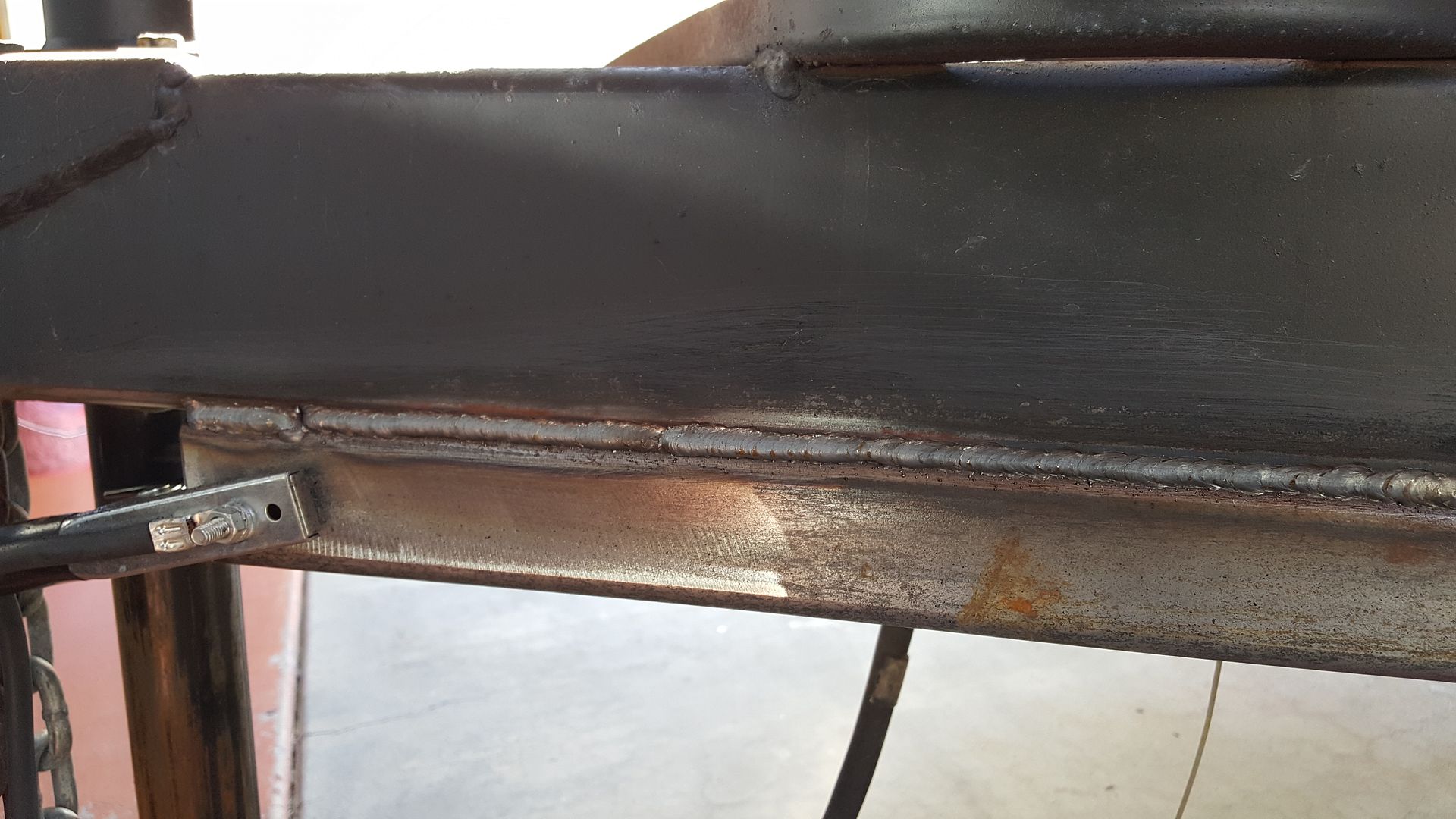

What do you think about this tongue reinforcement?
I have a 2007 Weekend Warrior 26' Superlite
It has the 3/16" tongue metal
It doesn't have any issues yet but my buggy is pretty heavy so I decided to reinforce some stuff
I searched the web and found some ideas including some that were done by weekend warrior themselves
I did these horizontal braces that another guy did to stop the frame flex and wall dropping
And now I want to reinforce the tongue. A guy said weekend warrior welded a square frame under the tongue like this. But it only goes back as far as where the tongue meets the trailer.
I'm not sure if that's good enough. Couldn't it still bend between the box and where the tongue meets the side frame?
A member here did a different type of fix where he welded 2x2 square tubing underneath the tongue channel
I'm not sure if that would be better
What do you think?
Like I said, I don't have a problem yet, I just don't want one in the future
