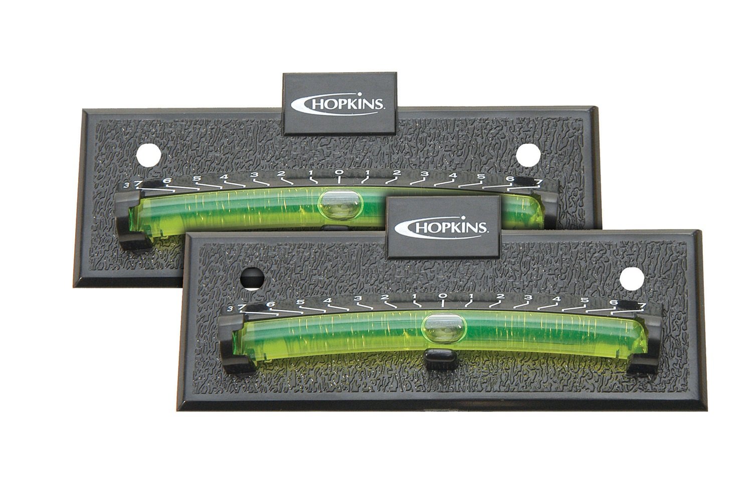

- tenbearExplorerThey may be calibrated in inches, but this is dependent on wheel to wheel spacing. Front wheels are not as far apart as the rear wheels and the front to back wheel spacing varies from rig to rig. You have to learn what he numbers mean on your rig.
- chrisandoctaviaExplorerThanks - I actually have a set of these Hopkins Levels as shown above that I bought recently - but the one on the door just came off (need to find some better adhesive)
- EMD360ExplorerI bought a set of these levels--
and mounted them inside. They might be the Hoppy levels the others mentioned.
The graduated marks are for inches out of level. Now we can tell if the campsite is level without leaving the RV. Also lets us know how many inches of blocks approximately for each side or front to back.
We always support both rear tires too. We use a combination of tri-levels, the ramp type of blocks and the plastic squares.
Asphalt can be difficult to level on if the blocks get pushed out of place by the tires. But for the most part these levels have simplified the process for us.
By the way, I realized the RV does not have to be level to apply these. Just apply level with the interior door and dash trim. - tenbearExplorerX2 on the Hoppy levels. After you have used them a while, you can figure out what blocks you need and drive up on them. Personally, I like 2 x 6s in 3 different lengths, tapered on the ends.
