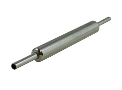

I think the connector is a MOLEX, and there's a tool to install/remove those terminals into/out of that plastic connector body.
 Tool is terminal size dependent.
But for most of us, removing those terminals is pretty much a one-time, destructive operation. And if we bugger the plastic, they won't stay in place once re-installed.
So we cut and splice like CD did.
