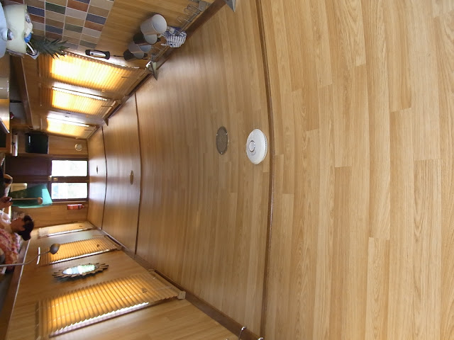

  • A few months ago, I finished replacing the ceiling in our motorhome.
    The foam between the ceiling luan and the vinyl deteriorates over time and the vinyl sags down. There appears to be three repair methods: total remove and replace, remove vinyl and foam and overlay with new material, or use thumb tacks to push the vinyl back into place.
    I opted for total removal reusing the existing vinyl and replacing the foam and luan underlayment. I used laminate floor padding for the foam which will not deteriorate.
    Project was time consuming, however, not very expensive or difficult.
    Jon
