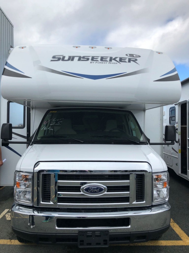

Some motor homes are flat-faced compared to others built on the same chassis. Then there is the size of the face. Some rigs are taller and wider than others. Given equal weight and identical chassis, a worse-case versus best-case scenario, you would see a change in fuel economy. How much? Who knows. But based on numbers shared over the years, I estimate a 10% difference.
A class C (B+) a best case scenario with aerodynamic cap, angled transition walls, narrow body, and lower roof.
I wish I could find a better worst case scenario, but here is something. - DrewEExplorer II

Aerodynamics have a much greater effect on fuel mileage than weight for highway driving. On level ground and at a steady speed, the only effect weight has is to (slightly) increase the rolling resistance of the tires. Air resistance, on the other hand, make up the greatest part of the friction that must be overcome, and further it goes up tremendously with speed increases--it's proportional to somewhere around the cube of the vehicle speed, if memory serves.
For climbing hills, and for stop and go driving, the weight is relatively more of a factor than for highway cruising.
The aerodynamics of the rear of the vehicle are at least as important as those of the front. RVs generally are pretty terrible at both ends; a squared off back generates lots of turbulence and drag, which is why airplanes and Priuses tend to have pretty pointy backs. - ron_dittmerExplorer III
