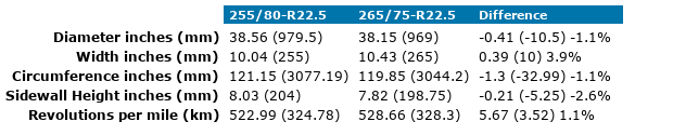

Recently purchased a 38' Dutch star and it needs new tires.
It currently has the 255/80r22.5's across the rear and 275/70r22.5's on the steers.
The only tires available in 255/80's are the Michillens which are quite expensive in comparison to the other sizes.
I am considering installing 265/75's all around and my concern is that these tires are 4/10's of an inch wider than the 255's which will decrease the gap between the duals by that much. There is roughly 3" space between the 255's that are on the coach right now.
Has anyone done something similar with their tire sizes and what were the results?
Thanks in advance.

  • Todd: Dual spacing should not be a problem. Minimum spacing for the 255/70 is 11.3 inch, for the 265/75 it is 11.6 inches. Spacing is a function of the wheel offset and can be measured from the center of the tread of one tire to the center of it's paired dual.
    HDS is Half Dual Spacing and is the rim offset. My Accuride 22.5 inch wheels have an offset of 6.44inches each so dual spacing is 12.88 inches...

  • I did exactly that last June. The 265/75's are the closest in overall diameter to the 255/80 thus virtually no effect on the speedometer or odometer. If you have 8.25x22.5 wheels, you have no concern with the increased width of the new size, a 7.5x22.5 wheel might create some concern and would have to be checked out for sufficient clearance. I went with Bridgestone R250's and have zero complaints in any department.
