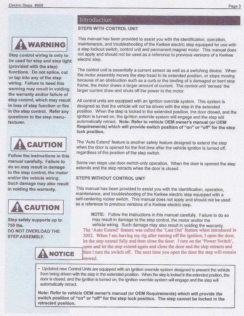

I feel like an idiot, but I simply CANNOT figure out how to make the steps to my coack (2010 Fleetwood "Discovery") retract when I put it up for storage.
I shut-down the coach, flip the 'disconnect' switches near the floor next to the door, and the steps stay out.
Please someone help remove my idiocy! :-)
