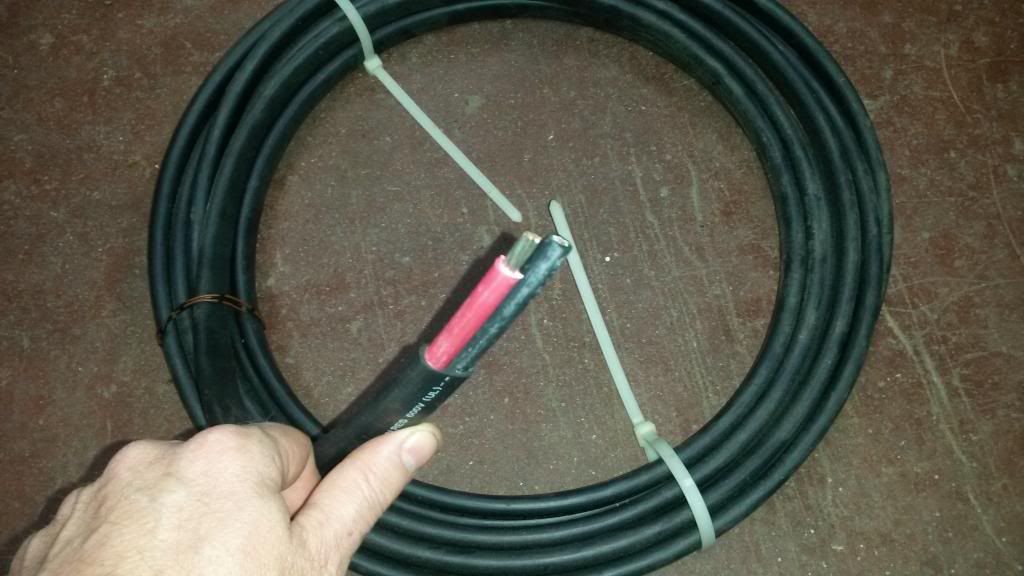

  • I still have some nice #6 power cables that was being thrown out from some jobs I did back in the day when I was an installer for Nortel 15yrs ago. I have more than enough to run double or triple if needed...lol

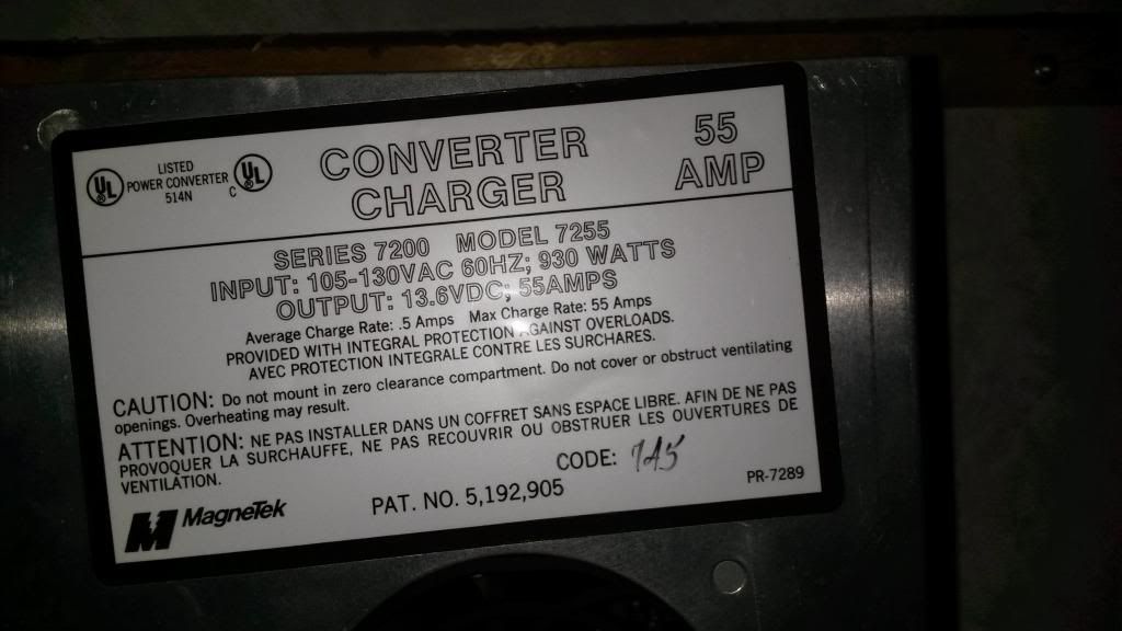

  • From what I know so far this will not meet my needs... this picture is worth at least a few words...

  • Hi Peter,
    What converter is in it now?
    Upgrading the amperage may require running thicker wire.
    If you boondock lots, then consider adding a solar system.
    Power max, Iota, and Progressive Dynamics will all meet your needs.
    Triple E has a reputation for excellence--so the existing converter may be just fine.
