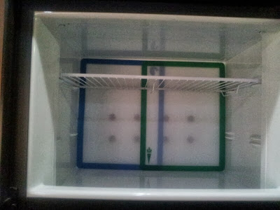

Flexible Cutting Sheets - Defrosting
I remember reading somewhere that to make it easier to defrost the "Frostfree" freezers in the RV some people had used those flexible cutting sheets on the back wall of the freezer. Being that we full time now, defrosting has been a major pain in the backside. We bought a package of the sheets in Quartzsite in January and the next time we defrosted installed them in the freezer. I want to testify that it works awesome!! I pulled the sheets yesterday and an inch of ice came off so easy! Nothing was behind them at all! The ice slid off like teflon from the sheets. I threw the ice out the door, dried the sheets and re-installed then. Whomever's idea it was, THANK YOU! If you do not yet do this, DO!
I have pictures on my blog of the installation if you want to see them.
Instead of hours, it took 10 minutes max!
