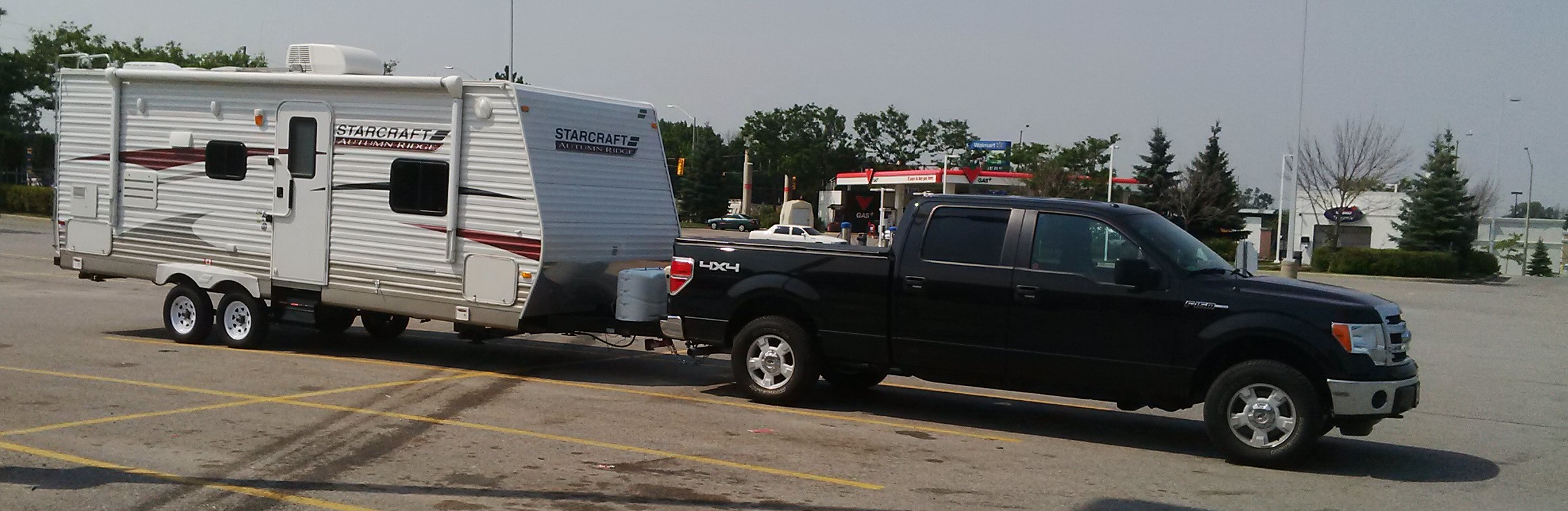

Bought my first TT and brought it home today. I noticed that when I look at the truck hooked up to the TT from the side, the TT angles downward toward the hitch somewhat. Is this normal, or is the whole thing supposed to be relatively level?
It's a class IV hitch that was factory installed when I got my f-150. The tongue is a 2 1/2" drop.
Thanks!

    The orientation of the trailers tongue should be level at it's highest
    pointing, to slightly down...when the WD adjustments are in the correct
    range

  • These folks will need a lot more info, but I'll ask the first question.
    How much does your hitch sag with the trailer on it?
