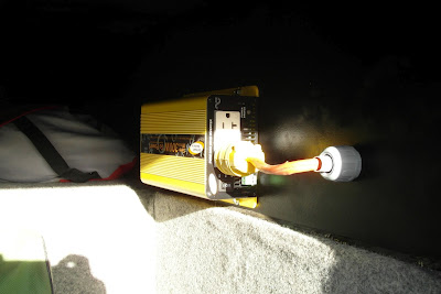

2112 wrote:Yes, it would still be 120V but the 2 sources would be out of phase which would still smoke stuff. I find it simpler still to just plug the shore cord into the inverter. Not possible to smoke stuff that way.
It would be 120V in parallel.
30A receptacle in shore cord compartment
Other end is a 20A plug into the inverter
