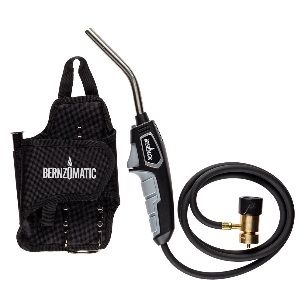

For big jobs like say 2 ga or heavier wire, a propane torch is the tool for the job..
The one I used in my how to document is like this one..
Which is a torch on a hose, pricy but very light weight since the propane can fits in a holster and the holster has a belt loop.

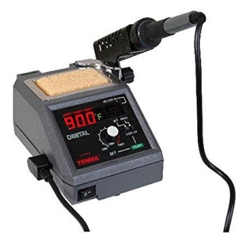

For very small soldering jobs, I use a soldering station and basically you have a very light weight pencil tip soldering iron with all the heavy parts in the base that sits on your desk.
The part you hold weighs about the same as a pencil!
Looks like this..
