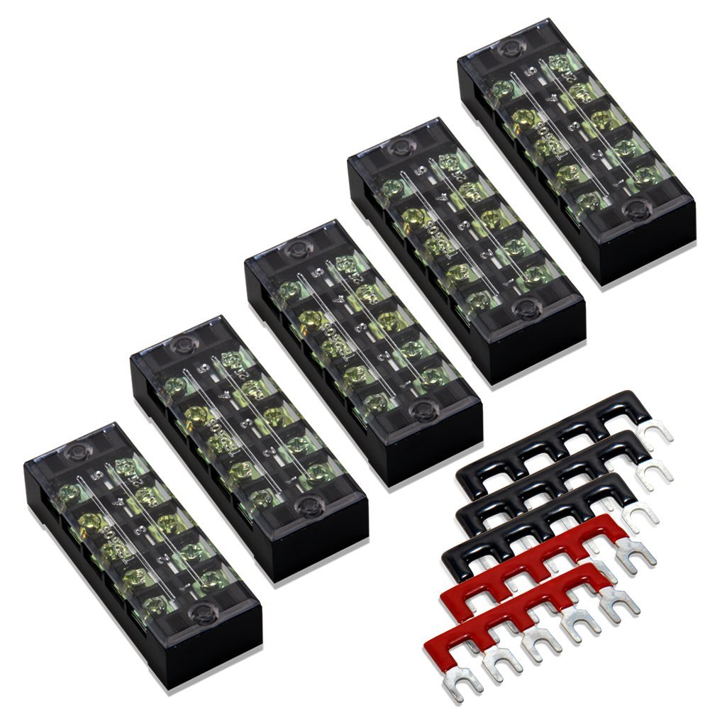

  • I found some small size multi terminal blocks on eBay with transparent covers and interference threads. The screws are never "loose" even when halfway out. I've used these with great success on Baja 1000 racers.
    AMAZON
    10pcs (5 Sets) 5 Positions Dual Row 600V 25A Screw Terminal Strip Blocks with Cover + 400V 25A 5 Positions Pre-Insulated Terminals Barrier Strip (Black & Red) by MILAPEAK
    by MILAPEAK
    Note the color-coded interconnects. Turns a block into a distribution center. The screw size is No 6. Then the transparent cover snaps on.
