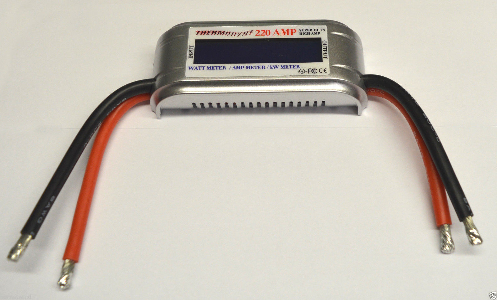

Here Ya Go Landyacht !
https://www.ebay.com/itm/220-AMP-HIGH-POWER-Watt-HOUR-Meter-BIG-WIRE-HEAVY-8-AWG-Solar-Wind-Turbine/232606182993?hash=item362868ae51:g:SgAAAOSwBjdaPewt
NOW READ'S KWH (hours) so you can track Kwh's (HOURS)
longer than any meter on the market.
Wire size matters -
Amps can over-heat small wires
You are bidding on an all in one -
CUSTOM MADE WITH 8g WIRE
OUR WIRE - THEIR WIRE
Ours will take the amps without getting hot
With custom programming and heavy duty parts to take
220 Amps? Like no other meter.
Not the same as any of the others on the market
220 Amp/Volt meter data logger with Heavy 8 Gauge Wire!
Great for analyzing battery charging
Caution: Do not disconnect meter from battery without
first disconnecting wind turbine to prevent voltage surges
This meter is a RARE find with THE heavy 8 Gauge silicon wire
since most meters only use 14G wire and can't take high amps
at low voltages like 12 volts which is common in wind turbines.
Custom Made For The Wind Industry.
BACK LIT LED SCREEN FOR EASY NIGHT VIEWING .
All other meters only have 12G wires
and those can get VERY HOT when used on
low voltage 6, 12 and 24 volt systems!
Make very sure that you buy the only meter on the market
made with heavy 8 Gauge wires. Buy ours or be sorry.

  • In my experience the 8awg gets quite warm at a constant 40 amps, and hotter closer to the 45 amp anderson powerpoles whose contacts are designed for 10AWG max, and the 12 awg got hot enough to be uncomfortable holding on tightly to it, but it never got stinky hot.
    Fascinating...
    OEM wire size for a 130 ampere alternator, 120" run is 8 AWG
    It may be the shunt and connectors are using the wire conductor as a radiator.
    45 amperes 3 feet length 8 ga wire should rise about 2F
    Start IR shooting shunts and connectors. You cannot feel the difference of 5F but a 5F increase in a termination point is a dead giveaway the termination point is the source of heat.

    The two GTpower branded wattmeters that I employ, one has been permanently on my Meanwell rsp-500-15 since October 2014. It only counts to 64AH before reverting to zero. The V and W letters on the far right of the screen are missing half their bodies and have been that way since December '15. It likely has thousands of hours on it at absorption and float voltages as I do noot cycle my battery each and every night, but will use 35 to 65Ah each and every night.
    The other GTwattmeter is a portable. I have 45 amp powerpoles on almost every load, and trust them unless the load is under 0.5 amps, where they will read low, and they will not register under a 0.18 amp load, but above this upto 40amps at least, they read fairly closely inline with my Shunted meter and my clamp on meter.
    Even with 8awg and no Connectors, I'd not trust them to continuously support more than 45 amps, though I do not feel heat coming from the body, only the wires.
    The claimed amp ratings should be considered for brief surges only, in my opinion.
  • 8 gauge carrying 220 amps without overheating hrmmm, the cable is made from a new super conducting copper alloy perhaps?
