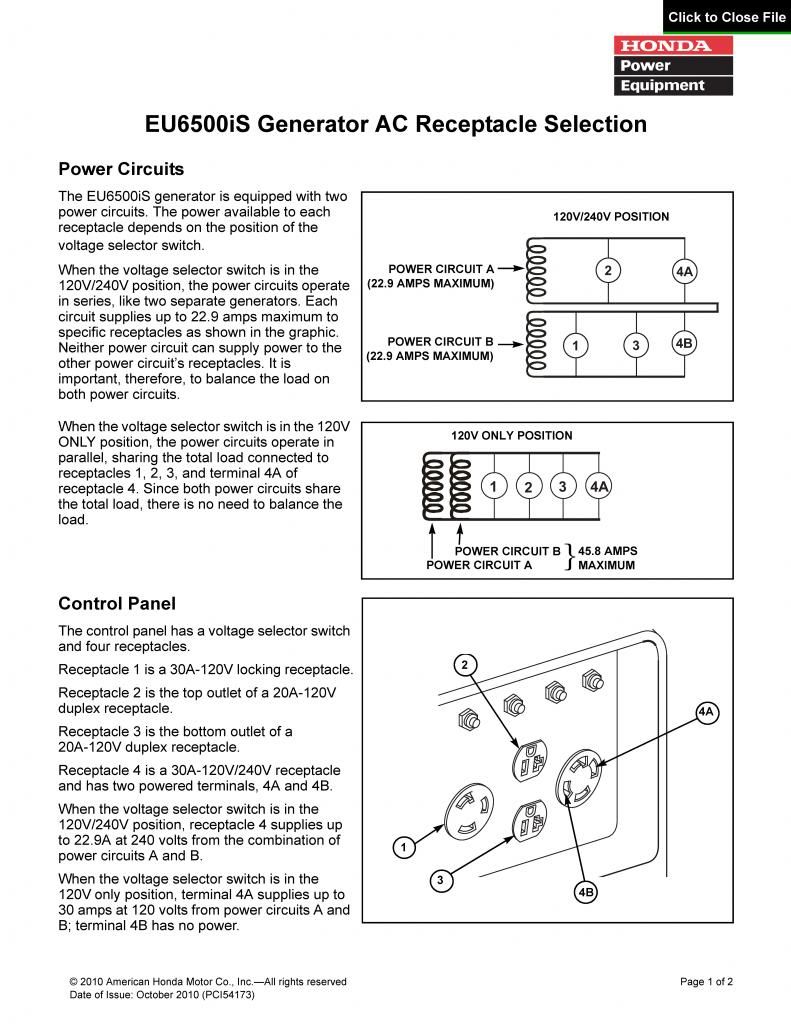

I'm looking at possibly getting a Honda Eu6500IS for my 5th wheel. I want to be able to run both A/C's, and right now my pair of Honda 2000's isn't able to do it. My only question is the plug configuration on the 6500. To me it looks like it has 120V service to a 30A plug, and two 20A plugs. On the 240 side it looks like it has a twist-lock 30A plug. Is that correct? If I want to run both A/C's, do I use the twist-lock 30A plug on the 120/240V side?

  • Here's the official handout from Honda:
    -Robert@Honda

  • Wayne Dohnal wrote:
    The eu6500is has two inverters. When running in 120 volt mode they're in parallel, and in 120/240 volt mode they're in series. With 50 amp service the easiest thing is to run 120/240 volt mode and plug the rig into the 240 volt outlet using a suitable adapter. If you can't run both air conditioners and it's just over the edge, you could maybe find success running in 120 volt mode which would take fiddling with the wiring. In either mode you have the same total power available. In 120/240 mode it's split evenly into 2 "buckets" where you might overload one but have some available in the other. In 120 volt mode all of the power is in a single "bucket", giving a bit more flexibility in how it's distributed.

  • The eu6500is has two inverters. When running in 120 volt mode they're in parallel, and in 120/240 volt mode they're in series. With 50 amp service the easiest thing is to run 120/240 volt mode and plug the rig into the 240 volt outlet using a suitable adapter. If you can't run both air conditioners and it's just over the edge, you could maybe find success running in 120 volt mode which would take fiddling with the wiring. In either mode you have the same total power available. In 120/240 mode it's split evenly into 2 "buckets" where you might overload one but have some available in the other. In 120 volt mode all of the power is in a single "bucket", giving a bit more flexibility in how it's distributed.

  • before listening to these people, why dont you tell us what service your trailer has.
    i can pretty much guarantee to get all the power u will need to use the 120/240 twist lock

    Only if you have a 50a coach. Maybe the downloadable owner's manual would discuss this.
