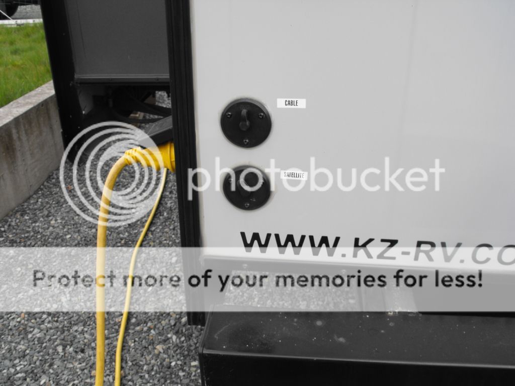

Our TT is factory wired for satellite TV. Has a co-ax outlet at each of 2 TVs inside and 2 locations outside and don't know how it's all connected. Dealer did not know and the manufacturer has no info. Does each TV location require a PVR and is one of the exterior co-ax connections one of the inputs? A TV is going to be connected with an HDMI cable so not sure why we have 2 sat connections outside? There is a co-ax connection at the rear of the trailer which is for cable TV input with a sat. co-ax next to it which would suggest it's for input??
