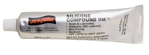

  • Seal with dielectric grease then, before reinsertion, after contacts are cleaned up.

  • Oooooooooo honorable bulbs from China. Been around for thirty years. not nickel plated. Aluminum. Goes well with brass, copper and lead. A veritable festival of corrosion. Glop on the silicone dielectric grease. The older 9002-4-5-6 OEM headlight bulbs had aluminum contacts mating with unplated brass terminals of the harness. Aftermarket bulb contacts were all too commonly not plated. Aluminum-copper-zinc with lots of current.
