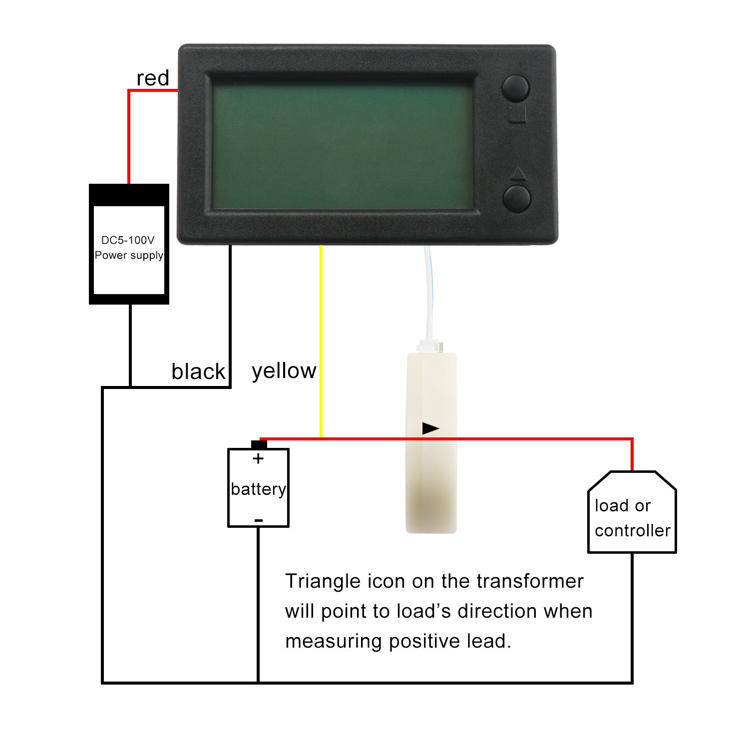

I have the first voltage amp meter that is linked, purchased from amazon. Can anyone tell me where to hook up the yellow wire? I know red + and black - go to their respective spots on the megawatt but am unclear what to do with the Yellow wire?
The yellow wire ties to the shunt negative.
If you are referring to
The yellow wire connects to battery positive - DieselBurpsExplorer

I have the first voltage amp meter that is linked, purchased from amazon. Can anyone tell me where to hook up the yellow wire? I know red + and black - go to their respective spots on the megawatt but am unclear what to do with the Yellow wire? - MEXICOWANDERERExplorerReality is mean
