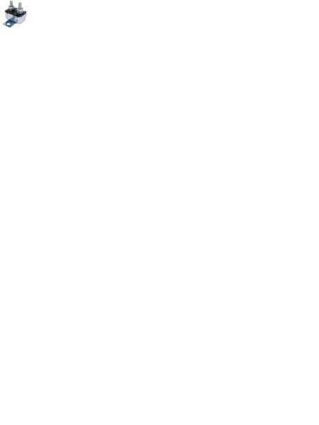

  • At the batteries trace the positive wire until it disappears into walls. Look for a small box (circuit breaker) with the wire going into and out of. You should get the same battery voltage on both terminals of that circuit breaker If no power out of the breaker use a screwdriver blade or a short piece of wire to allow power past the breaker as a test.
    Here's a picture of a common inexpensive breaker that many RV's use. They are available at almost any auto parts store.
    • GaryS1953's avatar
      GaryS1953
      Nomad
      I think your answer is probably correct.  The problem is I’ve not found easy accesss to the wires once they leave the battery compartment.  Guess I gotta start taking things apart🙁.  Thanks!
