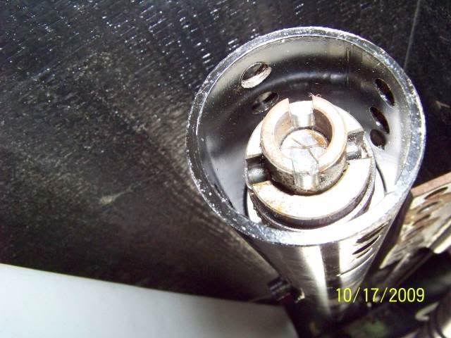

  • If you took that pin out in the middle i believe my problem to be in there.
