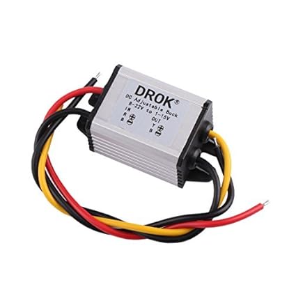

  • Forgot I also use one of these to limit voltage to my dashboard gauges:
    http://www.amazon.com/DROK-Waterproof-Converter-Adjustable-Transformer/dp/B00C0KL1OM/ref=pd_rhf_se_s_cp_4?ie=UTF8&dpID=41xGfo3wV7L&dpSrc=sims&preST=_SL500_SR135%2C135_&refRID=10ENJ494V9G94XARBD72
    The original mechanical voltage limiter was susceptible to RFI, and 7x as expensive to replace.
    Now the gauges do not swing with input voltage changes, but now I've got that issues resolved too.

  • Bumpy
    Watch the Amps and Watts rating, this was probably ordered for a specific purpose not whole house
    I use something similar as a trickle state charger to maintain the engine batteries
    And another one as a voltage regulator in the gauge console to keep a steady voltage on my gauges
    It used to be when I turned on the running lights, the fuel gauge went down and the temp gauges went up, because supply voltage changed
