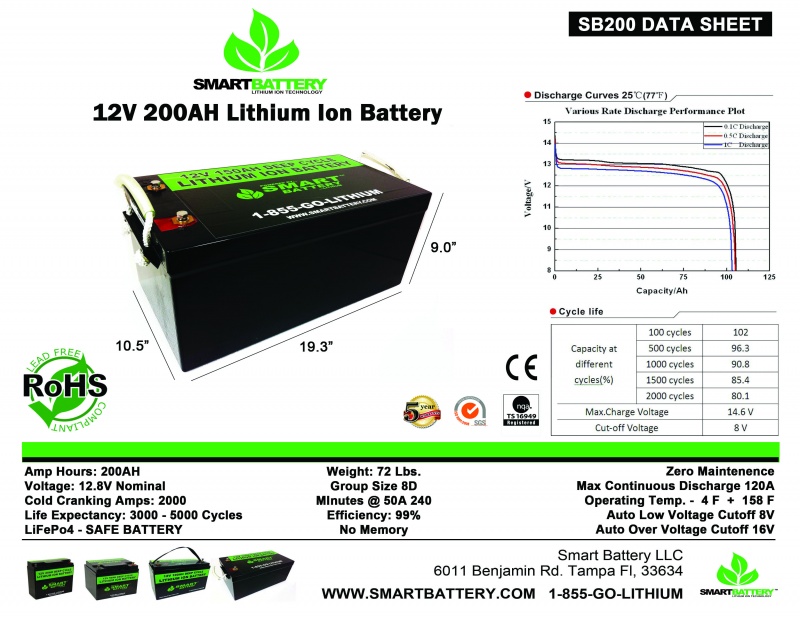

So these new technology LiFePo batteries has caught my attention recently, with all the new threads on the subject matter. They are almost out of the infant stage / bleeding edge / price gouging production stages and into the main stream / lower cost of production / economies of scale level for some of the fatter cats around here.
And it got me to thinking about how gas for the Honda Eu2000i is under $2 gallon, Honda's are now made cheap in Thailand, and LiFePo batteries just LOVE to suck up the amps at ridiculous charging rates, pretty clost to a 97 to 98% level of charge.
What is this going to do for battery amps capability of charge controllers for the dry camper? How much shorter run times are we talking if you really Honk on Bobo the generator and make it earn it's keep? What about the absence of taper charging except near the very end? What about the favoribility of keeping the batteries charged in the middle 80% and longevity and charge cycles of these batteries? Is 2000 or 3000 charge cycles the reality and how much capacity do you lose towards the end of the batteries life cycle?
Heady times, and a whole new bunch of cutting edge industries and products will need to come down the line to meet our new needs.
You thoughts on generators and charge controllers and charging speed/run times for the new breed of batteries?
