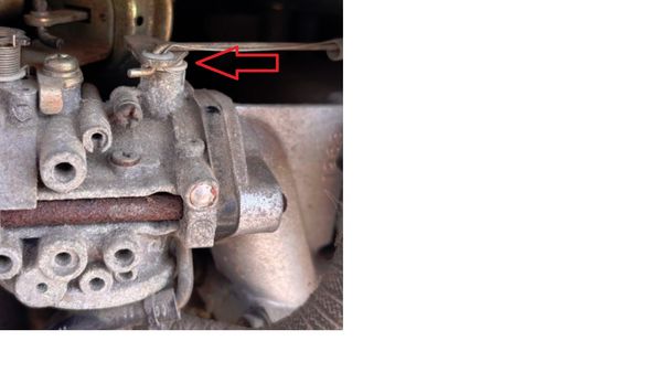

    Also we are confused by the term metal butterfly that you said you moved. Yes there are butterfly valves inside the carburetor, but typically you don't need to manually move them.
    Is the below what you are moving when you say metal butterfly?

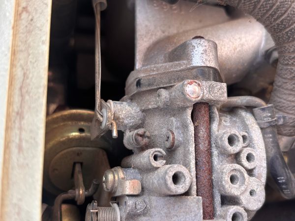

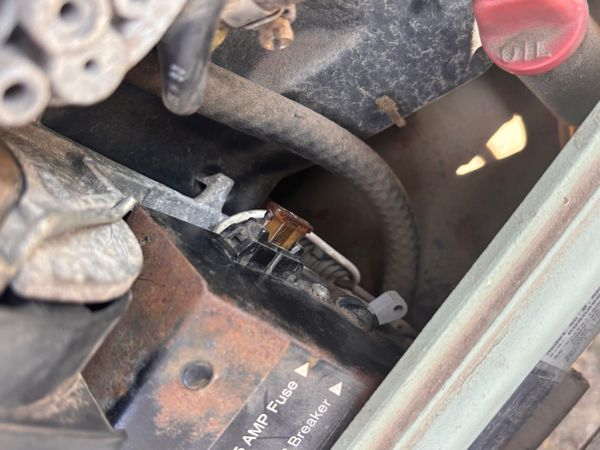

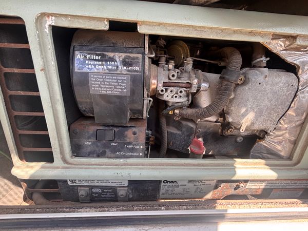

  • Here’s some pictures!! I have try against to turn it on today. I did the same thing I press the start button and the metal butterfl, yesterday make some sound like if it was going to turn on but today there’s no sound at all!! Thank you all for all the good advice
