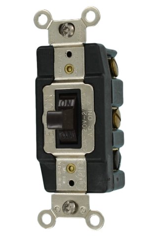

It also seems to me that I could use a 2-phase (DPDT) 30A switch to switch between my dryer outlet (inside) and a RV outlet (garage), using a switch such as the Leviton 1288 to switch power between the dryer and the garage outlets.
Leviton 1288:
However, I read over and over about people frying their RV trying to hook up shore power various ways from their house. SO I wanted to try and clarify what I think would work and get feedback.
Leviton 1288:

My plan currently is:
- Turn off dryer circuit breaker (safety first!)
- Disconnect existing circuit from dryer outlet
- Connect circuit from breaker to a DPDT switch such as the Leviton 1288 (linked above)
- Connect one set of switch outputs to Dryer outlet
- Connect second set of switch outputs to Garage RV outlet
Lastly, I want to again point out that this scenario would only supply 30A to each 120V leg even though we would be using a 14-50 style 50A RV hookup plug. This limitation comes from the breaker box itself. I cannot replace the breaker with a 50A because it would involve pulling new 50A wiring, and might violate dryer safety.
So, ..... thoughts?
