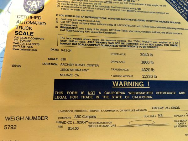

  • Still concerned? Take tow vehicle and trailer to a CAT scale.
