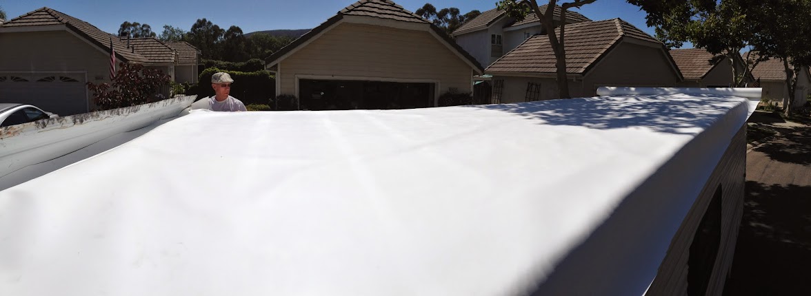

    Flash forward to 3 PM. SuperDad to the rescue again! We rolled out the new TPO and talked strategy. The videos all make this part looks so easy, but the truth is that TPO is heavy, clings to the sheathing, and likes to bunch in the corners as you attempt to fold it back on itself. We found our stride and soon we were laying down adhesive. Important note: once the TPO goes down, all the holes in the roof disappear, so you better have a really good mental picture to work from so that you don't step through your new roof!
    Dad and I working out our strategy:
    We had the TPO down in about an hour's time and we started screwing down the stress bars. The forward and aft straps are no-brainers aside from one major detail: The forward section should be wood substrate, TPO, butyl tape, skin, butyl tape, stress bar from bottom up. The aft section should be wood substrate, skin, butyl tape, TPO, butyl tape, stress bar. This ensures that there is never a path for water to be forced under the TPO while underway in the rain.

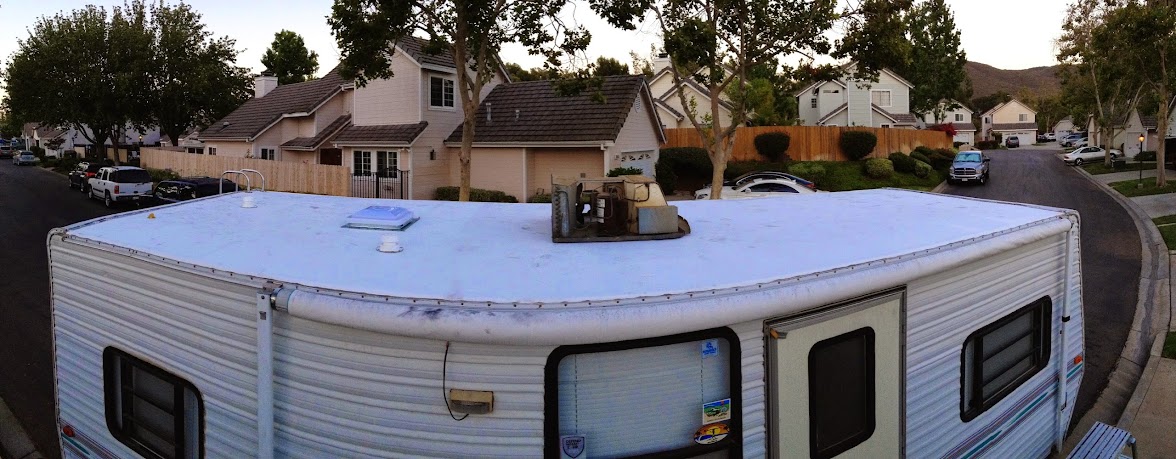

    With the TPO glued down and secured at the front and back, we pulled the side taut and stapled the TPO in place.
    Then, we installed the side stress bars. Finally, I started to work on each of the corners. I was disappointed to find that the new transition was not even close the factory transition and I really struggled to get the side straps secured. I'll probably end up filling the gaps with Dicor lap sealant and wrapping the whole mess in Eternabond. Sigh. I was able to install a few of the roof fixtures before the sun went down. Tomorrow will be the details day...and an over-due dump run.
    Here's the trailer as it sits this moment:

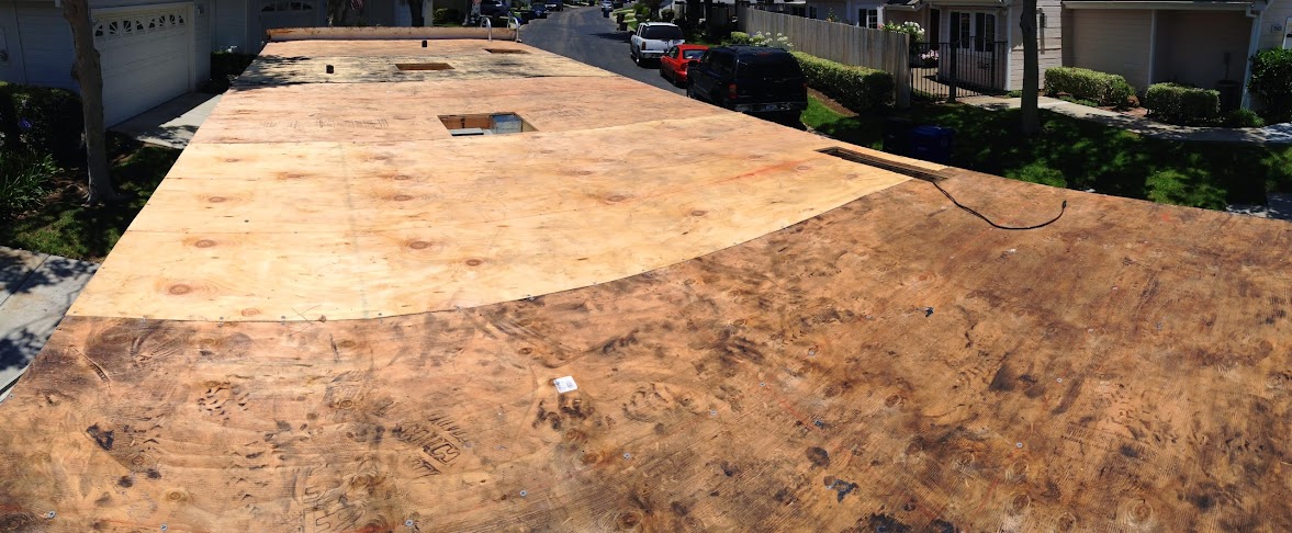

    The toddler got sick yesterday and I had to spend most of the morning watching Elmo and Frozen to keep her happy. Nap time came around and it was game on! I secured the sheathing with deck screws on 6" centers along every rafter. With the sheathing secure, it was time to cut holes in my brand new roof. I was initially planning to use the old luan sheets as templates for the new sheathing, but I found a video on YouTube that Dicor put out detailing the steps to install a new roof and the biggest take away was the process for cutting the new openings. The crew drilled a few pilot holes where each opening was and plunged a router into the hole and used the existing framing as a guide. Brilliant!
    Here's the roof with the sheathing secure and all of the holes cut. Note that I have deleted the tv antenna (this thing is for camping!) and the radio antenna. I also plan to delete the luggage rack...no unnecessary holes!
